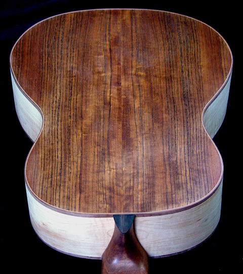

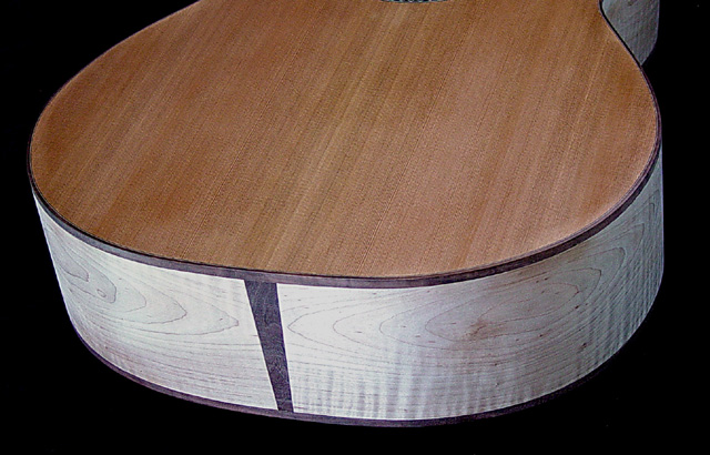

I have successfully bound my first guitar (NO GAPS), and plan to French Polish after the fretboard and neck work. The back is Ovangkol. The neck, bindings & graft are Black Walnut. The top is WRC. The sides are Maple.
Since the Maple sides and cedar top do not need pore filling, must I mask them off for doing the E-Poxy pore filling.
Ray

Very nice looking work, Ray.
For a 1st time user of Zpoxy, I would recommend masking. Once you get used to handling it, you'll be able to do so without masking. Even if you get a little messy on the sides, you will remove it during final sanding, but you really want to avoid getting epoxy on the top.
Good luck!
